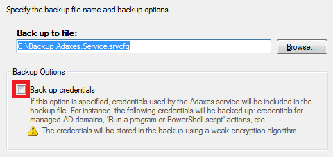

We doubt that the situation with DCs can be a cause for the issue. Can you do the following to help us troubleshoot the issue:
  1. Backup the configuration of your Adaxes service. For information on how to do this, see Backup/Restore Service Configuration. When making the backup, on step 2 of the Backup/restore wizard, uncheck the Back up credentials option.
  2. Send us the backup file.
